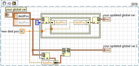

attach your vi not pictures plz
clean up your vi:
don't have cables under things, don't have cables going the wrong way, don't overlap stuff
get rid of sequence structure (use only if you cannot guarantee execution order with cables)
how does your "start smc" vi react to incoming errors?
do you really need a global variable?
example:
note that the image above is a snippet, which can be dropped onto a block diagram,
you can create this yourself by going to "Edit" -> "Create Snippet from Selection"
If Tetris has taught me anything, it's errors pile up and accomplishments disappear.
