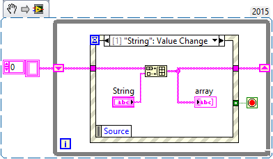

Just to give you the basic idea:
You'd probably want to add some sort of input validation, check for an empty string, etc.
