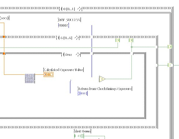

The first picture is the part of the program (inside the inner while loop) that captures the image .The stop button inside the same while loop will terminate the capture image process.
There is as such no delay added inside this loop. But still we can see the iteration of this loop takes some time.
The second picture contains two flip flops-(start and stop): start is the start acquisition . The loop in the first picture will be executed only on pressing this start aquisition button.

Two while loops and two sequence structures. Ouch!!! Can you please write in details your entire application. There has to be a better way.

 BTW I am not able to properly view your second image. A glimpse......

    A CCD camera is attached to a (software)tunable filter. In our project we are supposed to take images at certain wavelength.After selecting a particular wavelength in the filter we need to focus the camera . Here I have combined the two different vi's using a sequence structure. The problems I am facing are:
1) The control never goes into the filter section(first sequence in the main structure)
2) Since the image captured is still image I am not able to adjust the focus in the live mode
3)When I tried imaq , errors which I have mentioned in the long previous posts in the same thread occured.
 So I put one more while loop which iterated the capture image. And I have combined some functions which were previously as different cases into one case ,so that it may take less time. Again another problem was
4) Even though there is as such no delay in the image cature loop, it takes some time to execute same task. For example when the execution reaches the intensity graph from the array, it is not immediately displaying image.It waits for more number of (3 or 4) reaches to display the image.
Hope this was meaningful and advance thanks for the efforts you are  taking to solve this problem out.
Am sending the whole modified vi .
