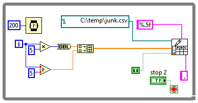

How do you create and write a 2-d array??  I have two operations in the same WHILE loop.  Each execution of the loop should generate a new  pair of values.
However, the BUILD ARRAY function only outputs a 1-d array to the WRITE TO SPREADSHEET FILE.vi.
Perhaps, more broadly, how does one put data into a 2-d array as it is collected?  I think I am building two arrays simultaneously below, but, what I really want is to build a single 2-d array.  Is this how you would do it?  It looks clumsy connecting sequential BUILD ARRAY's together.  Is this creating a 2-d array that I can search later by index and return the paired data?
Lastly, why does my front panel indicator only show data in the first column??  How do I make it display the data as it is collected across the rows?

For what you are doing, why not just generate all your value pairs (built as a 1D array) inside the loop, then wire the indexed output (2D array) to the Write to Spreadsheet File?
Otherwise, build your 1D array from both scalars (don't use a build array for each which is why you're getting only 1 column of data), then run that into a single build array.

Instead of writing it continously you can auto index the values and write to the spreadsheet at the last (as given by BillMe).

Here's a simpler way, just write out your X and Y as a 1D array each iteration. The Write will append your data as a column of X's and a column of Y's:
or generate all your values and then write once:
(fix the broken wire).

OH, I think I see what you are doing.  Each iteration, you are writing a 1-d array of  my precious x,y values, and then appending array after array to the spreadsheet without transposing, which means they write in rows instead of columns.  So, each data pair is its own 1-d array.  Is that correct?  Would that same way work with 3 data values, e.g. x,y,z data?  I suppose we could write as many elements as inputs we chose the BUILD ARRAY to have.
Message 7 of 8
(3,449 Views)
Yes, you are correct.
