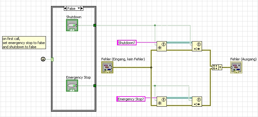

I am working on a small side project that will allow for a central shut-down or emergency stop button. Sadly I have a problem as I wanted to read in a queue reference, and this is different depending on the queue datatype...
My VIs use a reference containing a string, my example queue consists of a cluster of a string and a U32 - thus for LV the source and sink are different. How can I achieve the change behaviour of the NI VIs that change when wiring? Do I have to write a polymorph VI?
As a work around could I just pass the name of the queue and call it during runtime or would I get the same problems again?
I add pictures of the wiring (for users of older versions) and the lvlib for users of LV2010+

First question.  Why don't you change the subVI to match the type of queue reference you are passing in?  Why would you be trying to pass in more than one type of queue reference?  It seems like a simple single purpose subVI.  (Actually, I'm not sure how simple it is because it seems like a complicated interaction of two different notifiers with a queue.)  If you have a subVI that is intended to do one thing like this seems it does, then you design the subVI to work for that particular situation.
A common way to have a queue be able to handle multiple kinds of data in one queue is to include a variant as one of the datatypes in the queue.  Let's say you have a cluster of an enum (a typedef that defines the action you want to take) and a variant (a container that can hold any kind of data).  You bundle the command with the data and have it coerce or cast into a variant.  In the consumer of that queue, you read the command so you know what action to take, and based on that, you know how to convert the data in the variant bact to a datatype that you can use.

@Questionmarker wrote:
For the sake of reusability I wanted the VI to work with whatever queue I feed it. It is obvious that I could bash this VI to fit this quick and dirty example but I am not satisfied with that - I would rather like a more nice, reusable solution. The NI queue VIs also recognize what is wired to them and they change accordingly; can I also achieve this behavior?
Probably only through polymorphism like you suggested.  The reason is that the queue reference has the datatype of the data it carries inherently in it.  It wouldn't know how to adapt to any given queue because it would ultimately break the underlying subVI at the dequeue element function where it needs to decode the queue datatype and figure out how to distribute the data.
