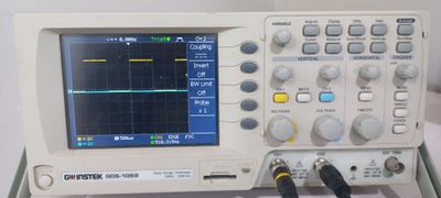

with this new vi I'm able to get some output.
But.....
I'm getting output as 0(blue channel) when there is a square wave on  "waveform".
and I'm getting 5(blue channel) as the output when at near  100% duty cycle.
Yellow channel is what I'm trying to follow.
