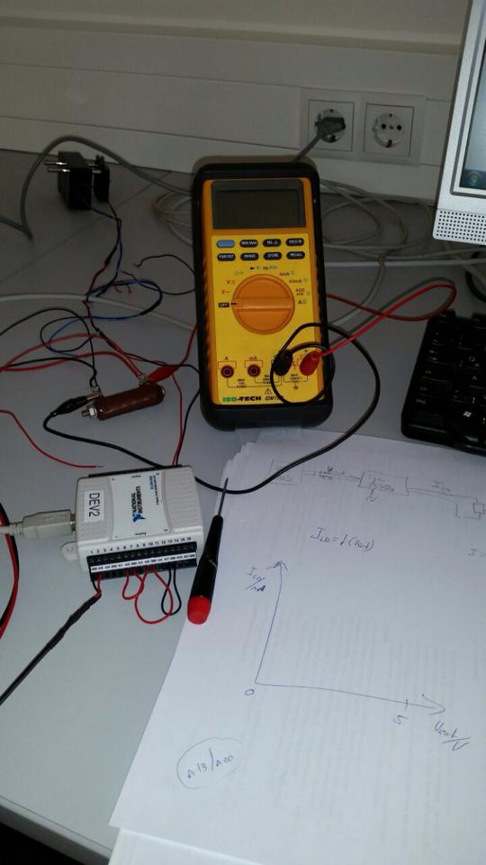

i understood that i can use ohmĀ“s law ....and also i have 10 ohm resister which is attach to my laser diode driver ...but my question is how to volatge vs current graph ...with step of 0,1 V....using usb6009  here you can see my graph which i am trying to get.....

Hi raoof,
These steps are required:
1 output a voltage
2 read the corresponding voltage across your resistor and calculate the current
3 back to step 1 for all voltage steps
4 display all current vs voltage values in a XY graph

You have to vary some voltage source as an input.  You measure the current by measuring the voltage drop across the resistor.  So for each set voltage, you have a current.  Build those numbers into two arrays (one for voltage and one for current) and use an XY graph to create your plots.
1.5mV across a 10 Ohm resistor would be 150uA.  How much current are you expecting?

how i can vary volatge ....?because i given 5V FROM POWER SUPPLY ,,how can i vary it..and where i should  read volatge drop ...as i am not able to see my multi meter please send me 2 array program sir.

How do you expect to do an IV curve when you can't set the voltage?  How do you tell the driver what voltage to put out?

billko is right here:  the help you actually need right now has nothing to do with LabVIEW.  Your problem is you don't even know what you are trying to test.
So from I have been able to gather here, the goal is to perform an IV curve.  What device is this curve supposed to be done on?  If you are doing an IV curve, you need a supply that you can vary, preferably via serial port or USB (so that we can control it in software).  The measure current, you will have a 10 Ohm resistor in series that you can measure the voltage drop and derive the current.
So let's try to get that setup before we start doing anything with code.
