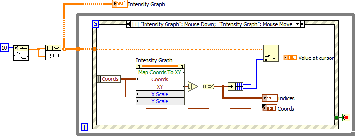

hello. I want to output the values ​​from the intensity graph.
I can't speak English, so I used Google Translate. Thank you for your understanding.
I want to output the value for the position when the mouse is clicked on the intensity graph, how should I do it?

Hi ndtsystem,
check out this solution, change the event to "Mouse Down" or "Mouse Up" due to your requirement.

No need to jump through flaming hoops getting the index. There is a method (invoke node) for that!
Here's all you need:
