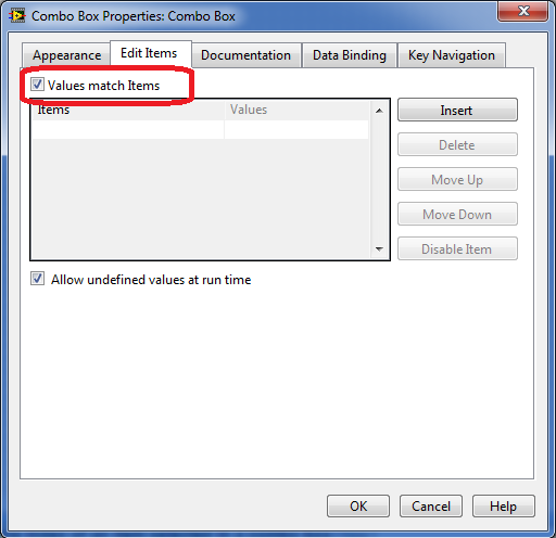

It's easier to change to Ring control or Enum which gives the index as default, a Combo box gives a string which must be converted. But if you really like the graphic design and want to use the ComboBox you can deselect "use strings as values" and enter the index as numbers, then do a String to Decimal conversion.

Hi
May I ask how to deselect "use strings as values" and enter the index numbers for combobox?

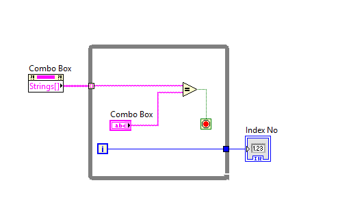

This will gives you index number of selected element
Message 9 of 11
(17,360 Views)
Nothing like replying to a 2.5 year old thread with a bad solution.  Exceptable solutions here, in order, would be 1) use a text ring or 2) use Search 1D Array.
