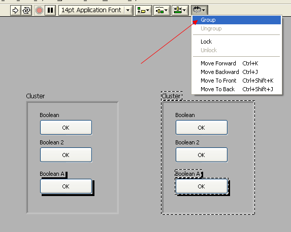

Group the "floaters" with your cluster, and you should be ok. It's a good practive anyway for when you move stuff.
Richard

imstuck,
I didn't mean put the buttons in the cluster, I meant use the grouping tool to physically group the hovering buttons with the cluster. try it! Smiley Happy
Richard

NICE!
