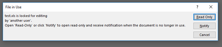

I have attached a vi that demonstrates the issues. I can open an excel template, save it with a new name, and then dispose of the report, and I will still be left with an Excel entry in the Details page of Task Manager.
This is an issue, because until I manually end the task, i can not open the excel file I just created to edit, I see the pop up message below.
