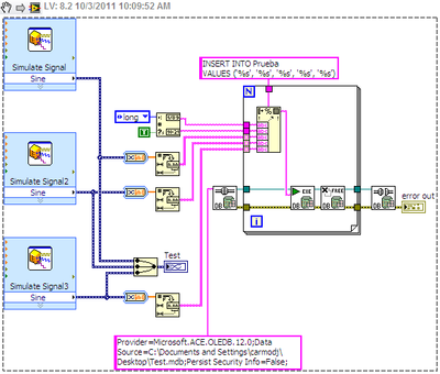

Hi, I'm trying to send dynamic data to a database in microsoft access, but I'm having troubles becuase no matter how many points I send it always appears the same number in my database.
I'm new in all this database with labview and I can't figure out how to send all the points of my dinamic signals.
Greetings and thanks!!!

I'm thinking that your problem lies in the fact that you're converting your dynamic data to a single scalar.  The Simulate Signal Express VIs make the same data each time you run them, and you're only taking (the same) one point from all of it.

Thanks for replying jcarmody.
The problem is when I convert the dynamyc signal to an array, the database can´t read it because only accept strings and I don't know how to make my database read that array.

My first thought was to write each point in a For Loop, like this:
My next thought was to convert the array into a spreadsheet string and store one waveform measurement in one database record.  I expect this would be faster because there's only one SQL INSERT happening.

thank you so mucho jcarmody, it works perfectly 🙂

You're welcome.  Which one?

the first one because the second one also gave me all the values but in a single cell

You should be able to modify JC's first to build 1 query instead of inserting line by line, assuming the total isn't too long. You can also simplify it slightly by using the Insert-vi.
