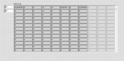

hi, i am trying to get rid of null values in 2d array, can anyone help me? previously i have tried following this step one but this case https://forums.ni.com/t5/LabVIEW/delete-0-from-array/m-p/2052658/highlight/true#M669106 for 1d array and when i try My VI is getting an error

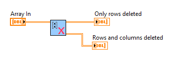

That example that you followed gives you an error because the Equal? function outputs an array of booleans, which you cannot directly input into a case structure as its conditional. Since you want to operate with a 2D array, each iteration in the for loop is a 1D array of its own.
Therefore, you would need two for loops to check each value of the 2D array individually.
I have attached a VI that accomplishes what you are looking for: reads each row/column of the 2D array, and deletes it when null.
I recommend that you use this as a subVI in your project.
Note how it has two outputs, depending on whether you want to exclusively delete null rows, or both null rows and columns.
Just drag the VI into your block diagram and you'll be good to go.
Don't hesitate to reach out for further questions,
Fort

thanks for the answer sir, actually this is an array of signal data that has passed the threshold, and I only want to store the values that pass the threshold value because of that I want to remove the zero values in the 2d array

okay sir, I will group this data based on the number, this zero value is meaningless. I will use this 2d array data for grouping using machine learning. I will train this data to move an object
I also want to make this data like this sir, data that has a value other than zero will remain in the column and row, I just want to remove the no value. my data will remain as much as the number of rows but will change in column values because of the omission of zero values
