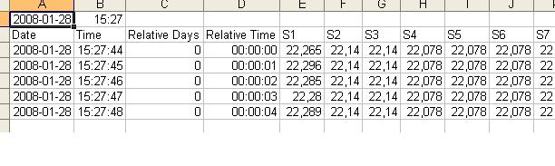

Okay, seems like I ran into some trouble...
I thought all I had to do was to read it back in with read from spreadsheet file, but all my timestamps were then gone.
Below are some screenshots, all I did was to read it with read to spreadsheet VI with file input and semicolon as separator, and then selected subarrays and formatted them as they were saved. (see excel import), but all I get i jibberish. Suggestions?
Message Edited by Tohatsu on 01-28-2008 08:40 AM
(3,087 Views)
Posting an image of the front panel of the VI doesn't provide much information. You should at least post an image of your block diagram and the best thing to do would be to post a data file and the actual VI. I suspce that all you have to do is use the Read From Spreadsheet File in string mode instead of dbl. Not sure why you would want to use a semicolon as a separator thoug. That would allow you to import the times (hours, minutes, seconds) into separate columns but the rest of the data would be incorrect.
(3,078 Views)
reading them as string worked excellent, since I dont have to interpret the data, but only filter out the unwanted parts, it made my day 😄
On the semicolon part, there are several reasons:
1) Semicolon is not used anywhere in the data
2) to avoid the problem with some having comma as decimal separator and some having dot (user speciffic settings)
3) to make the file readable "to the eye" as a long sensorname would shift everything one column if I used tab separator.
oh, and time-values are not separated by semicolon, it's separated by colon.
But thankyou for the good solution!
