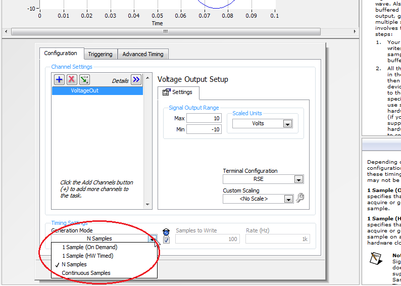

actually i built simple labview to generate analog signal ..
the problem when i change the value it is not change on the output terminal of Daq
i have to stop the program then run again it will be changed
how can i solve this problem ?
attached picture from what i have built ...
thanks

Have you choosen generation mode as 'Continuous'...?? If so, try set it 'N Samples'...!!
Using the attached picture, nobody will get any idea about how is DAQ Assistant configured...!!
Better to share the code..!!

I TRIED THIS ONE
AND I SET THE VALUES FOR SIMULATE SIGNAL AS
FREQ=10
AMP.=5
OFFSET = 0
SINE WAVE
SO THE DC VALUE IS -0.628 USING MULTIMETER AND SELECT dc VOLTAGE
WHEN I TRY TO MESURE USING ac VOLTAGE THERE IS NO VALUE
(2,701 Views)
WHEN I SELECT SIGNAL TYPE DC
and put offset = 5
i mesure the output is equal to 10v ???
(2,700 Views)
can you share the code???
Edited: Also, are you using multimeter to measure square (or sine) waveform output??? Why dont you check it using an oscilloscope...??

now it is working
i select DC signal and it give me in the multimeter same value
thank u very much bro 🙂
