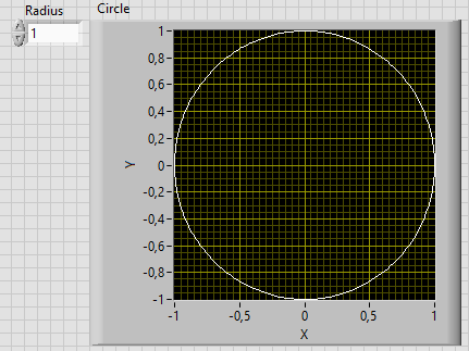

create a circle using only the radius and without using sine and cosine
I have tried to complete this but I have no idea where I am going wrong, the weird thing is that after the number 50, I think, it creates a half circle but it starts at number 8 of the Y.

I love you very much, I started to base myself on your code to make it in the form of a block diagram since I was asked to do it that way and not with code or something else that makes it much easier. I am already making progress, you have helped me a lot.
but as you can see I'm still missing

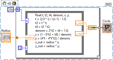

You still did not do a "save for previous", But try something like this...

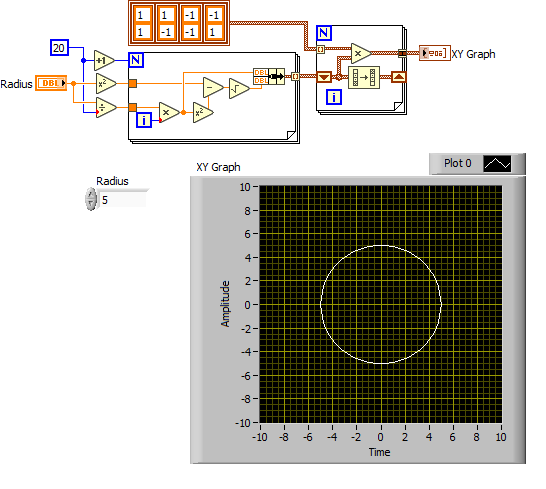

where that orange/cafe array is located/created
Message 7 of 12
(689 Views)
It is an array of points where a point is a cluster of two DBLs, one for x and one for y.

Technically, you can avoid this if you compute the upper and lower halves of the circle in a single for loop, something like this:
Message 9 of 12
(659 Views)
I would even do a loop free solution.
I still strongly prefer my first suggestion because the circle is guaranteed to close and the points are evenly distributed around the circumference.
Attached are both versions.
