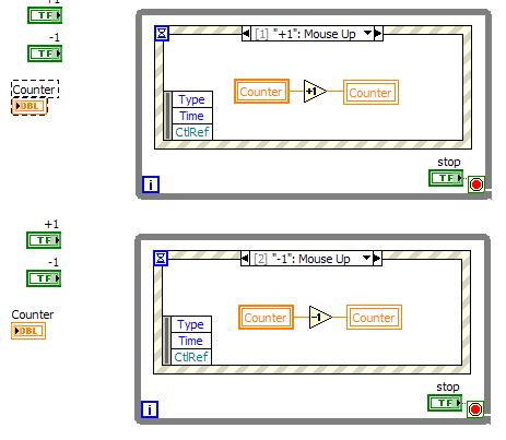

I need to make a program that keeps count, whether i press a "minus 1" button or a "plus 1" button in the while loop. I'm not sure on how to actually convert the boolean logic of the button pressed to equal an addition of the number? Any comments appreciated!

Mathan, were both of your buttons supposed to increment it? Or did you forget a case?
Is there any reason you don't want to use a simple numeric since you want to increase and decrease it manually?
The up and down buttons are your plus 1 and minus 1 buttons with no booleans or logic..

This one actually works. Just messing with you Mathan but yours only counts up.
Tim

aeastet, my version of LabView is to current or too old, can you snap a screen shot of the VI false/true part?
Message 7 of 12
(5,300 Views)
I'm sorry, should have clarified, but I do want the count to increase or decrease according to the +/- buttons pressed continuously
Message 8 of 12
(5,299 Views)
here are the screen shots.
Tim
GHSP
Message 9 of 12
(5,288 Views)
What version of LabVIEW you are using? Here is his program in 8.6.
