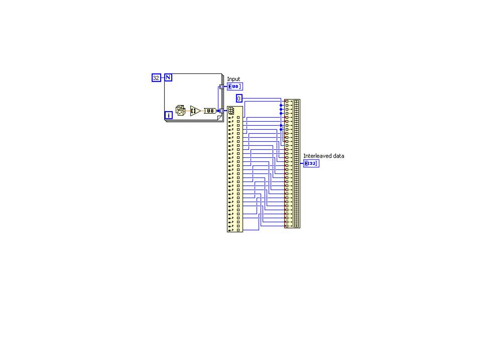

Here, I have attached the VI's that I came up with. But the design is fixed for 4 channels. If there are 100's of channels, I can't use this VI.
So, I want to design a generic VI which should be able to perform interleaving for any number of channels.
For this, single buffer(array) should be used instead of separate array for each channel if I am not wrong. I am working on it.
Please help me out in implementing this.
Thank you.

It's interesting to note that all the complex code in your example can be replaced with a pair of array index/array build functions.Interleave.jpg
I wouldn't normally recommend doing it this way, but it is the most direct method for four channels... and helps to illustrate exactly what you're trying to do.
Having done that, I can see clearly that  you want to build one array from another, with the indexes shifted as such;
0, 0, 0, 0, 4, 1, 0, 0, 8, 5, 2, 0, 12, 9, 6, 3, 16, 13, 10, 7, 20, 17, 14, 11...
(I put some zeros in red to indicate that they are the value zero, not the index zero.)
This follows these rules:
  • If I (index of result) is divisible by 4, use i (index of input)
  • If I/4 has remainder =1, use i-4
  • if I/4 has remainder =2, use i-8
  • if I/4 has remainder =3, use i-12
Or, to put it more concisely: use I=i-4*iREM4
The attached vi will accomplish this, for N=4.
if you want to use more than 4 channels, just change the 4 constant to whatever you want it to be.
