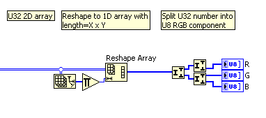

here is my block diagram . i used functions in IMAQ Visions, as u can see. Thanks for ur help !!!

OK, let's backup a few steps 😉
It seems you have your image as a 2D U32 Array (blue) hat you feed into an array that turns it into a 2D array of RGB clusters and now you want to make 3 1D arrays, one for R, G and B, resp.
SO... the question is: Why do you do this expensive (memory and CPU) detour via the RGB cluster??? This makes absolutely no sense. You can get your desired result directly from the U32 array with a few easy steps. See attached image for one possibility to do this. 🙂
SInce you were talking about making 1D arrays, I reshaped the 2D array into a 1D array with a length corresponding to the product of the 2D dimensions. If you actually want to keep the RGB arrays as 2D, simply leave out the reshape function. 😉
