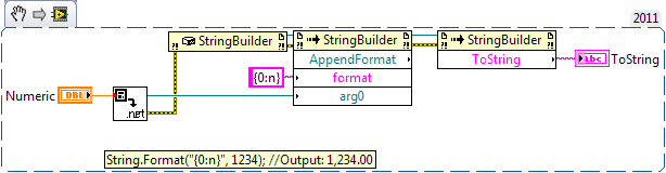

I managed to do this:
Num to separated string.png/Y
