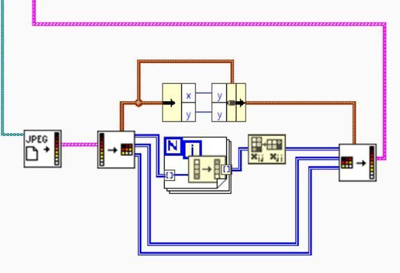

Thanks altenbach for the clarification, I thought to do that I would need IMAQ tool ! Can you please assist in detecting these variables?

You have 2D array data that you can slice and dice as shown and do some simple signal processing.
A picture indicator can show the picture and there are plenty of tools to detect mouse interaction and draw decorations (lines, circles, text, etc.) in any color. No IMAQ needed.
As a first step you need to define the scenario bounds.
  • Is the sight glass always fully visible or can parts be cut off?
  • Is the magnification always the same?
  • Is the picture always greyscale or can it be color?
  • Is is always exactly vertical or can it be tilted?
  • Does it always have the same number of markers over its length?
  • Is the liquid always darker than the space above it?
  • How fast does the level change?
  • What is the required precision?
  • etc.
Message 22 of 34
(259 Views)
For example just doing the average brightness of each row shows the pattern of major and minor tick marks, the zero line, the sight glass limits, and the level. A simple 1D feature detection can get all required information. Try it!

I think the pixel at zero line could be found using the same code and then the rest of the calculations to be donecalculating pixel of zero number.JPG

The zero line is the only one that is present on the left half of the object and is the only real sharp feature, you could apply a filter on that column data and see which point changes the most, for example.

Using this vi resulting 800 which somehow close to 797 that could be detected visually.

I got that solved. please see attached picture. The issue I am facing now is when the position of the opject changes, the vi wrongly calculates number of lines!! is there are way to fix that?
