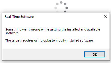

Thank you Santhosh and Rolf,
I discovered that there are likely other issues which prevents use of recent LV versions.
Here is the installed software list:
So clearly cRIO need an update. However when I try this I get this reply:
I have logged into linux and it does have opkg installed:
admin@cRIO-9030-01A044D4:~# opkg -v
opkg version 0.2.2
Albeit a 0. version so presumably a bit old.
The question is then how do I install the latest LabVIEW software given this error message?
Admitted - this is a new question compared to my initial question. But I cannot verify the suggested answers before this new problem is solved.
I have considered
erasing the whole thing but I need to have confidence how to go from there.
Thanks for any insights you may have.

The first step after formatting is to check in NI-MAX what firmware version is reported for your chassis. opkg 0.2.2 would indicate that there is probably quite an old version installed. You should probably have firmware revision 6.5.0f0 or something along these lines. If it shows 3.something you have definitely still an old firmware that will not support newer LabVIEW installations.
Once you have a recent firmware on the chassis, the next step is to install the LabVIEW software runtime and support for the LabVIEW version you have. You can select all the individual packages if you really want to, but it is usually much easier to select the according NI-CompactRIO toolsuite, For LabVIEW 2019 you want the NI CompactRIO toolset 19.x, usually 19.0, or 19.1, 19.5 or sometime 19.6 for if you have LabVIEW 2019 and either 19.5 or 19.6 if you have LabVIEW 2019SP1. Once the LabVIEW Realtime Runtime on the chassis matches the version on your development computer, you should be able to connect from the project to the chassis and deploy compiled LabVIEW VIs to it.
But I would definitely try LabVIEW 2020/2021 (32-bit) if you are not using a cRIO-904x or cRIO-905x. 64-bit support for other cRIO chassis is likely not yet present in NI-CompactRIO 21.0.
Rolf Kalbermatter  My Blog
This worked nice and smooth - after assembling the courage to just _format the disk_, then no more dramas!
As I showed in the NI-MAX clip previously I formatted it from a right click menu.
Once that was done I was offered to install a handful of Linux OS versions including a legacy cRIO. I went with the newest version for LV2021.
Then the relevant LabVIEW tools was added.
All this from within NI-MAX
I can confirm - LV2021/64bit does not work - 32bit does.
I did already have the newest firmware on the device as this was one of the first things I updated.
For the record the system is now configured with NI Linux Real-Time x64 4.14.146-rt67, firmware 8.8.0f0
I have a final clarifying question: What does firmware mean in this context? Because as far as I know often firmware means the entire code in an embedded system, but this can't be the case here.
