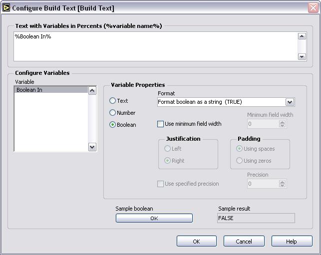

It's true you have lots of options. The easiest way (perhaps) to convert a boolean value to string is to use the Express VI in the String functions palette called Build Text. All you have to do is enter the name of an input variable surrounded by percent signs (for instance, %Boolean Input%), then select in the Express VI what type of input you want. For boolean values you can choose to format the value as a binary text (0 or 1) or as True or False. Here's an example scenario:
Message Edited by Jarrod S. on 07-05-2006 12:23 PM
