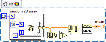

Here is an example with a switch for row or column averaging.  The TRUE case of the case statement contains a Transpose 2D Array.
If you want to average the whole array, you can do this easily by using Reshape Array, then Mean.vi.   Here is that example.
