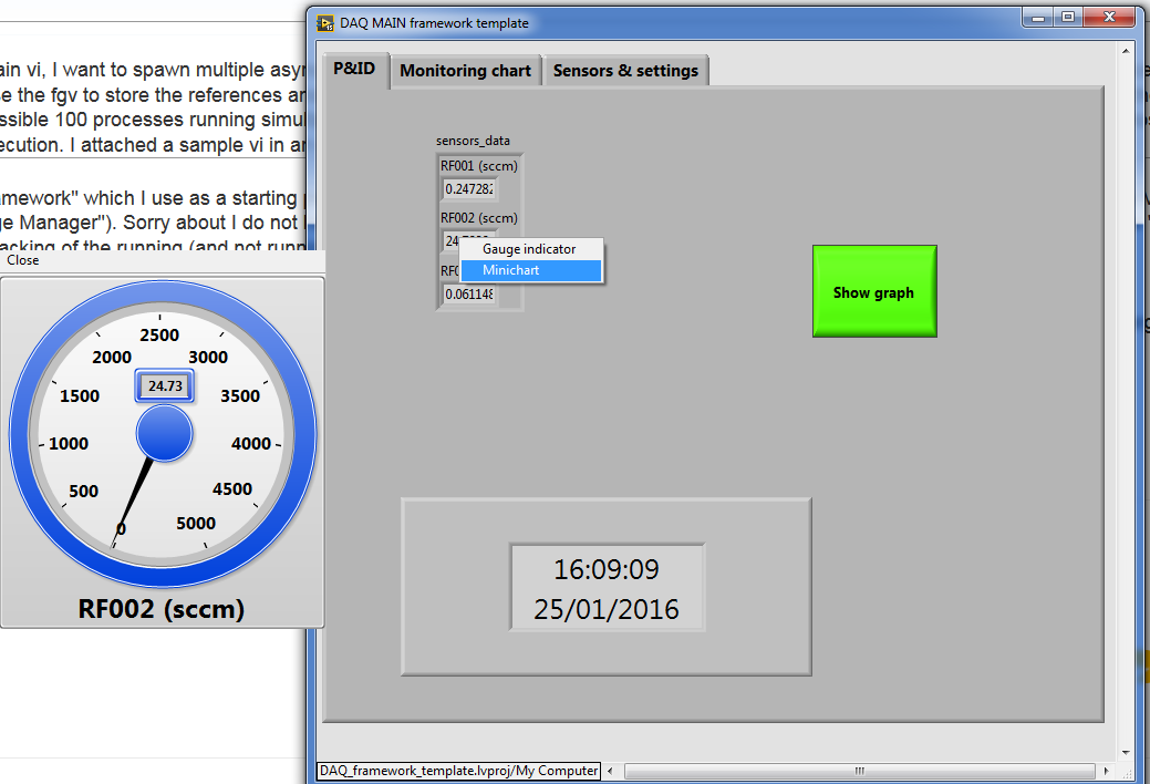

@timi13 wrote:
 I have main vi and from that main vi, I want to spawn multiple asynchronous instances of a process. I am using the call and forget option because I want the processes to continuously run. I wanted to use the fgv to store the references and names of these processes so that I can open the front panel, close the front panel, and exit the process I choose. I will have possible 100 processes running simultaneously. I should note that in the VI I am spawning, in the vi properties->execution, I have chosen the preallocated clone reentrant execution. I attached a sample vi in an earlier post. I will try to post vi shortly
Please find attached a kind of "framework" which I use as a starting point for a recent project. I zipped a version 2015 and also 2014 (you may need to install some MGI and openG addons via the "VI Package Manager"). Sorry about I do not have time to remove unrelated parts, but you can see how I spawn parallel processes using the "call annd forget" method, and how I keep tracking of the running (and not running) tasks using an FGV. So maybe this project example can give you some ideas...?
Run the main VI, and you can spawn the reentrant VIs (gauge and chart indicators) by the custom menu via right click on the example indicator cluster...
Feel free to use these VIs, or part of them. This project is not optimal for sure, I would say it is more a playground to test different ideas for me... (as you see the Large XY Graph indicator window app also not optimal, I use an FGV for data sharing instead of the better way, via UserEvents...).
