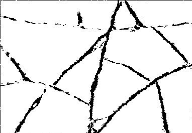

I ve wrote algoritm that detects cracks i some structures, so i get output image like this:
The I separate cracks into objects like this one:
This cracks are random, only sure information is that their length is greater than thickness
Then by drawning circles inside  thickness measurement is done
I wanted to use centers of this circles as set of points that i gave in 1st post.
Maybe I can use this binary image to make approximation??
Aim of that is to find angles in crack, I ve arleady done that in diffrent ways but this approach seems to be the most promising and universal...

In the area circled on the copy of your image below do you interpret this as two cracks intersecting or two long cracks with some short fragments which should also be analyzed?
The next crack below the circle has a slight bend near the center.  Is that two cracks with an angle to be measured or will it be treated as one crack?
I might try to do linear fits on the crack data.  When you identify straight line segments which represent the cracks, you should be able to calculate the angles from analytic geometry.

Pixels are grouped by blob analysis, that place You marked are separate objects.
I am thinking on other way to Group this cracks but no idea so far
I ve thinked about analytic geometry but again i face problem of gruping points because in most cases i wont get straingt line ;/

If the material is crystaline, then the cracks will be straight, microscopically, because they follow the crystal structure.  Of course you will get some curvature due to offsets along the structure planes.  That does not seem to be a major factor in your image.
Why not start by doing the easy parts first.  Fit straight lines to the longest segments.  Where they intesect, calculate angles. In areas like the one I circled the separate objects may be identified by points being farther from the fitted line than the points at the left edge of the circle.  For example suppose that on the "clean" part of the crack 90% (arbitrary) of the pixels are within 5 pixels of the line. Then any area which has more than 10% of the pixels 6 or more pixels away from the line has multiple cracks.  Some of the cases will have multiple objects which you will probably not be able to resolve completely.  They may not meet the length greater than thickness criterion. Or there may be so many small cracks that you effectively have pulverized material rather than intact crystals with cracks as boundaries.
