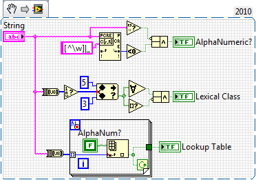

Here is my side by side:
Now can someone explain to me again why And Array Elements returns true for an empty array?

Hopefully the OP's question has been answered five different ways so this diversion is ok.
Explanations I have heard range from the ever helpful "It has to return something" to the slightly more informational "The default use is to look for a single false in a sea of true values, so the de facto default is true".  In my mind, Booleans are False until explicitly set to true so empty elements should be considered False (like in Or Array Elements).  The annoyance is that this choice requires negation to add a check for the empty case.  And Array Elements AND NOT Empty Array.  If AndAE returned False instead, you could use a simple OR with the Empty Array check to get back the current behavior if you so desired.
From a performance standpoint i guess that's the solution choosen since it'll stop the comparison earlier and could save lots of comparisons. The function should include "and not empty array" in itself since, as you say, an empty array should default to false.
