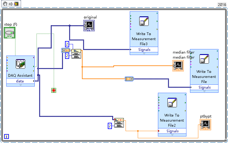

I'm using a median filter to process a very noisy signal but I'm not getting the signal I want.
The signal comes from an antenna in a noisy environment(hot, windy, dusty), after envelope detection it is transformed into voltage signal. I use ni usb-6002 to acquire the signal. Here is the snippet of the block diagram I use to process the save the data.1.pngI use the daq assistant to get the signal from usb-6002. Then I save the original data, the data processed by meditan filter.vi, and the data processed by median filter point by point separately as tdms file.

Sorry, I don't know how to read your files, but how long are these "glitches" if you zoom in?
(Also, since you have an array of data, your use of the ptbypt filter makes little sense. How is the DAQ configured? Sorry, since I don't have DAQ installed, I cannot look at the express panel)

Sadly, the NI Forum people "broke" the ability to post Snippets to the Forum and have us pull them off to get working VIs (I, also, am "guilty" of ignoring the message saying "Don't post Snippets as images, attach them as files or attach the underlying VI", until Billko pointed out the problem to me).
Please post your code.  Also, post the sampling rate you want to use, and give us some idea what you would ideally like as a filter frequency (I assume you realize that a Median Filter acts like a low-pass filter, right?).  This will dictate a reasonable width of the Median "window".
There are (at least) three possibilities why the LabVIEW result is not what you expect it to be:
  1. You don't quite understand what a Median Filter is/does.
  2. You haven't implemented the Median Filter so that it "does what you want", as possibly distinct from "does what you tell it to do".  Note that another way to express this possibility is "Your code is wrong".
  3. There's a bug in one or more NI function that you are using (as opposed to the possibility that you are using the wrong function, or using the function in a wrong manner).
I'm betting that #3 is not the answer.  Once we see the code, and know better what you are hoping to see, we can comment further.

hi! Thank you all for your responses!
I'm not sure where is the image viewer when writing this reply so I uploaded both the snippet and the actual vi here and I hope you guys can see it. Just incase, for the daq assistant, I set the sample rate=50 ,samples to read=50, I use RSE mode and continuous sampling.

I get another set of data. This time for the daq assistant, I set the sample rate=100, samples to read=100, RSE mode, continuous mode. For the median filter, I set left rank=50, right rank=50, for the median filter ptbypt, I set the rank=50.

You again show us two plots with DIFFERENT Y-scales to compare. It does not make too much sense, if you want to compare signals "by eye", at least use the same y-scale! Do you understand the difference?
About your hardware config and DAQmx settings:
  • I would stop using Express VIs, and switch to proper DAQmx functions along with a Producer/consumer design pattern
  • As I see you use RSE terminal config, I would try Differential it might improve your signal-to-noise ratio
  • Did you check your cabling is properly done? Grounding? Read the grounding consideration whitepapers: https://www.ni.com/en/shop/data-acquisition/measurement-fundamentals/analog-fundamentals/grounding-c...
  • You use a 50 Hz sampling rate. I would just increase the sampling to the possible maximum (50 kHz), and do an averaging in the Consumer loop. You might even do not need any filtering in this way...
