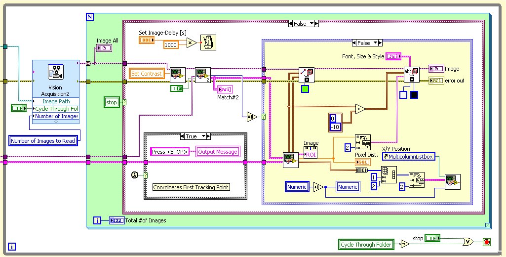

The other point about the zooming during the aquisition is still not working correctly as I already mentioned. Below you can see a
screenshot of the while-loop:
Do you see where the problem is..?

Hi Norick,
are you trying to zoom and set a ROI using the toolbar on the left of the front panel's image display or
do you want to perform those actions programatically?
From your loop I can see that you set the ROI programatically through a property node.
This is OK but if you run your loop fast you will have no chance to change the ROI through the toolbar.
Otherwise there should be no reason why the tools would be deactivated.
If you can post your VI I will try it out here on my PC. What version of LabVIEW and Vision Development Module are you using?
What is your Vision Acquisition version? You can see all this in MAX's Software category.
David

What I am trying to do is following thing. A part of my front-panel looks like this:
As you can see I can activate the zoom-tool (top left corner). Now, during the image aquisition I would like to zoom in to the image while the aquisition is still running (loop) while the ROI is set programatically. I do not set the ROI on my front panel. The problem is that there is no access (I only can select it) to the zoom tool on my front panel, meaning that it has no effect (no zooming) while the aquisition is running. Even I set an "image delay" there is no chance to use the zooming.
Is it because I am still in the loop or...?
-> Unfortunately I can not send you all vi's.
thanks
(3,777 Views)
Additional note:
- I am running the described loop in a event-case. The even-case itself the "lock front-panel" is not set. It seems that the whole event or loop is blocked for
any action I do on the front-panel. I also can not use the scrollbars of the image neither to select any ROI tools. Everything is "disabled" for interaction.
