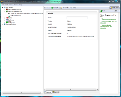

I tried wading through all 9 pages of this thread and it was a nightmare, so for anyone who finds it in the future, I am reposting the step-by-step process that worked for me, including creating the label and the drivers.

To communicate with the printer, I went into the NI-VISA Driver Wizard, took note of the PID and VID

Let it do its thing and when it finishes, open up MAX and you'll see your device listed under Devices and Interfaces.
Then I ran a simple VISA Open-Write-Close with the string generated from my .prn file, and I got my label! The text you see in the snippet below will print a label that looks like the one from the first picture. Make sure you have a new line after the "P1" command at the end, otherwise it won't work.
