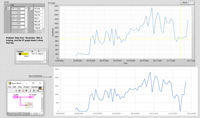

Hello community,
I'm struggling making an XY graph with some data missed. In this example, there isn't data from Nov 19th. I was wondering if there is an easier way to generate the correct graph instead that said in this post:
https://forums.ni.com/t5/LabVIEW/To-find-the-missing-date-in-a-month/m-p/507357#M241845
Thank you

Hi vicens,
How much easier do you want that?
When you look for "missing" data, then you can search for that in two ways:
  • "step by step": go through your (ordered list of) elements and detect missing elements
  • "check them all" by comparing with a list containing all expected elements
The linked thread uses the 2nd method, but you can also implement the first one!
I prefer to "hide" missing elements by using an Y value of "NaN" instead of "zero"…

Thank you GerdW,
I thought using Y values with a date format the T-axis of the graph would autoadjust automaticaly. It looks like I was wrong.
So, as you suggest me, I will follow the "step-by-step" procedure, filling the missing elements and adding the NaN value.
Best regards
vicens
