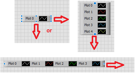

Your description is too ambiguous. Please attach your VI or illustrate it with a picture.
Your plot legend can be resized horizontally or vertically, but to go in the other direction, you first need to resize it to only show one element.
That's it!
Thank you.
Why didn't I think of "stretching" it to the right?
Sigh!
