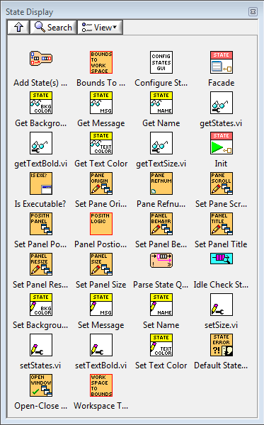

4 - Additional original distribution problem
The class methods in my functions palette have read crosses next to them. This indicates an issue with scope and/or license as mentioned by Daklu and AQ in LAVA here
As I can drop the method onto the block diagram (it is public) and the VI is not broken?
But these two problems do not seem to be a related with my release.
Is it a bug?
Do you know what could be causing this?
Flat File distribution and palettes are attached.

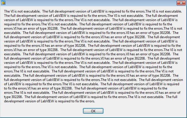

When I went to build the application I got the following message:
There is not much on the web about 302208 that was helpful, a search mentions run time engine mismatches etc.. but that was not an issue
On trying to find the cause of this I got the following shorter error message from the app. Again the KB says missing drivers.
The build process was also crapping out, saying it was done in seconds (but really this build takes ~ 5-10 minutes due to class etc...)
LabVIEW would the crash.
I found the issue which was having a reference to an Xctrl in a class.
It was in the Class so I could encapsulate UI changes.
The class was part of my work project application (not related to the Xctrl distribution at all)
I have to further investigate this to see if it is related to the original problem above or not.
But I thought it was worth a mention.

  2. Using the LabVIEW Palette Editor to create a palette shows red crosses ("x") in the bottom left hand corner for class member VIs when that Class is a public member of a Library (and the Class members VIs are public also). The red crosses are seen in the palette but not in the palette editor at time of creating the palette.
