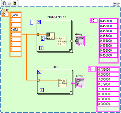

I never said you should add arrays, since you already have three arrays of doubles.
Post your new code. From your description it seems that you are repeating the write 100 times with the very same text, which does not make any sense. The loop must also include the line formatting part of the code, autoindexing on the three arrays and removing the Index Array nodes.

Again thank you for your reply. I am attaching a screenshot of the current situation. So as you said, I should remove the Index Array?

Do you really know what is an array? Before going on, I recommend you to go through the LabVIEW tutorials. In the main page of this fourum you will find links to Training Resources, like http://www.ni.com/getting-started/labview-basics/.
After that, check the following example:
Paolo

Hi Paolo,
polymorphism is part of the LabVIEW training:

Sure, but polymorphism does not help the OP to recognize his main error.
He definitely needs a loop and autoindexing in his code.
