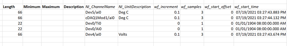

Dear GerdW,
Thanks very much for your help! I really appreciate it.
As per your suggestion, I was able to build an array with all my signals and write it to a TDMS file. Thanks for the tip!
I'm connecting all 4 of my DAQs to my computer using a USB 2.0 4-port hub.
I have all the DAQmx VIs connected to the "OnboardClock", but the ULx VIs can't. As you can see in this screenshot of my TDMS file, the Omega/MCC signals have an entirely different start time than the NI DAQ signals. And even the NI DAQ start times are off by a few milliseconds. Do you have any suggestions for how I can make the start times line up?
Paige
(2,371 Views)
Hi Paige,
To have those devices all start at the same time you would need to synchronize them or to use a start trigger for all of them.
As said before: syncing capapbilities might be quite limited with your rather cheap devices…
I know for sure the USB6008 only supports an external start trigger: do your other devices support such a trigger signal?
When it's only for "cosmetics" you might manipulate the t0 element of your waveforms to use the same start time in all of them… 🙂
(2,365 Views)
