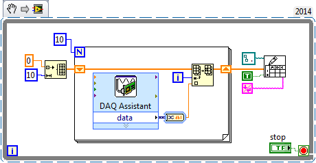

I am acquiring voltage data continuously. My loop reads 1000 samples, averages those samples, writes the result to a measurement file (appending the data to previous data), and repeats.
I want to change my VI so that every 10 loops I write 10 data points (from the 10 previous loops) to a data file. This way I am writing my data less often and my loop will run faster.
I have found a way to write my data every 10 loops, but this method only writes the data from the current loop (not from the previous 10 loops).

How can I modify this method to include the data from the previous 10 loops?

You just want to write the previous 10 averages? You could simply append each one into an array that is maintained in a shift register. After writing, empty the array.
you can do something like this.

Hi Solobo,
This might be what you look for.

Dennis_Knutson: Yes, that's my goal. I think I understand what you're saying in principle,  and that seems like the simplest solution. I'm a little fuzzy on how to clear the array and start gathering again.
Munna232: Is your example just increasing the size of the array indefinitely and writing it once when its size is 10? Or is there something I'm missing that clears the array and starts over after writing 10 samples?
NateMan3148: I think I see how your example would work, but I need to think about whether it would hinder or help the speed issue I'm having (every once in a while my save operations freeze up for a bit and my buffer fills up before I can gather more data to clear it).
crossrulz: I'm saving as a .csv and acquiring data continuously @ 1kHz. I'll share a screenshot of the code below.
Re 1: If I open the file before my loop and close it after, then do I lose data if something causes the computer to freeze up? The reason I'm writing data often is as a "back up" so I don't loose my data if the loop is not allowed to finish for some reason.
Re 2: I haven't heard of Producer/Consumer architecture, but looking at your link it looks promising: if I'm understanding it correctly, I would acquire data outside of both loops. My first loop would then do calculations on the data and append processed data to "buffer" of sorts using a shift register. My second loop would then look at that "buffer" and acquire / save data from it at its leisure. Is that the gist?
Screenshot of my current code (writes only every 10th data point):

solobo wrote:  Re 2: I haven't heard of Producer/Consumer architecture, but looking at your link it looks promising: if I'm understanding it correctly, I would acquire data outside of both loops. My first loop would then do calculations on the data and append processed data to "buffer" of sorts using a shift register. My second loop would then look at that "buffer" and acquire / save data from it at its leisure. Is that the gist?
No.  You would have one loop do the acquisition as you have it now.  You could have it do the mean and the other calculations as well.  But then the second loop logs the data.
Also, you could combine both of your two FOR loops into a single loop.  You could also Autoindex your Rp Val and Offset arrays instead of using the Index Array.
