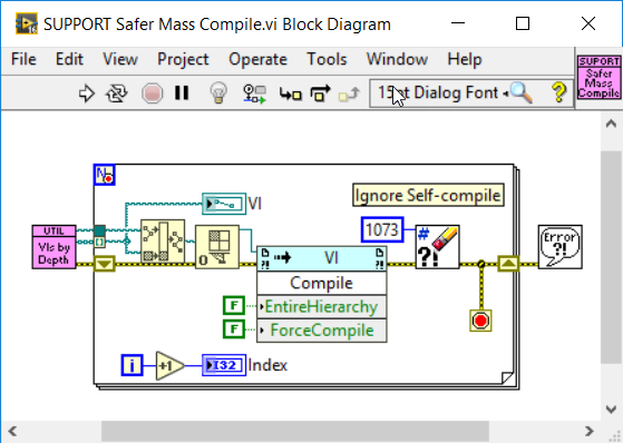

I'm guessing that the problem here arises when multiple Requests-to-Compile occur when working with a VI that has several "layers" of nested sub-VIs.  What if you did the equivalence of a Mass Compile, but forced the order to be Deepest-first in the File/Folder Hierarchy?
I cheated slightly.  I have my Project arranged in Virtual (and corresponding Disk-based) Folders, with sub-VIs and Type Defs having their own folders, and with the Clone routines also having several "layers" (including their own sub-VI and TypeDef folders).
So I wrote a routine, "Safer Mass Compile", designed to be run from within the Project.  The "real work" is done by the routine "VIs by Depth", which finds all of the VIs in the Project folder and sorts them by the number of sub-Folders it takes to get to them.  Here they are (in LabVIEW 2016, the earliest Version that supported Channel Wires and where this routine might be needed):
Vis by DepthVis by DepthSafer Mass CompileSafer Mass Compile

The "solution" is in the original post.  I didn't describe two of the VIs -- Find Project Folder uses the assumption that it is included in the Project Folder and does a recursive search up its Folder Tree looking for a .lvproj File.  Relative Paths simply shortens the full path to the VIs by removing the path to the Project Folder.
