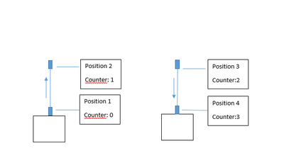

I need to understand how I can implement a counter in labview that increment the count after each movement down to up and up to down of my wire potentiometer. Look the attachments example:
Can you help me?

What is Position 1 to 4?
IF "movement down to up" THEN "increment count1"
IF "movement up to down" THEN "increment count2"
  • IF-THEN-ELSE is a case structure in LabVIEW.
  • Increment is a "+1" function.
  • Data (like count1/count2) is stored in shift registers.
See how far you get.

A wire potentiometer is an analog device with an infinite number of settings.
  • Who operates it?
  • How is it connected to the Analog input of your DAQ device?
  • What defines a "movement"?
    • Any change in one or the other direction (above thermal noise)?
    • A full turn?
    • Hitting one of the limits?
(1,334 Views)

Hmmm, we call that a "string pot" and use one to measure displacement on our seismic table.
If I was to do what I think you are trying to do a counter would not be what I would use.
Since a string pot is a potentiometer you need to measure its resistance or apply a voltage across it and measure the voltage at the "wiper".
The center (resting position) would be your "zero". Increasing resistance or voltage drop would mean it's moving on one direction, decreasing resistance or voltage drop would mean it's moving the other direction.
With the proper scaling you should even be able to determine the amount of displacement.

here show I interpreted the question
I used levels and hysteresis to detect the not clear up->down ..
