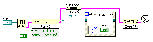

Hi MitsuMan,
I verified that the SubPanel works fine even in executables calling VIs from a shared network drive. Please try the attached example (SubPanel.vi) that calls Tester.vi or whatever VI you point at with the "vi path" control. If you don't have LabVIEW 7.1 you can build the VI from looking at the code behind the SubPanel.vi here:
Let me know if it doesn't work, thanks.

Hi MitsuMan,
Now I think I know what you mean. You want to be able to show an already running VI in the Subpanel window of an executable, right? Well, the reason that you can't do this is because it's not possible! If you point to the Development System by specifying "localhost" (of the executable) to the "Open Application Reference", you can get the reference to the VI if it's already loaded as a VI.
However, when trying to embed the VI into the Subpanel, you will get an error 1147: "Cannot insert a remote VI in a subpanel control." Sorry, but that feature is not supported. Notice that you can still run, stop and everything else that you normally want to do with VI Server - it's just the Subpanel that isn't supported for "remote" VIs.
Useful tips: You ALWAYS point to the opposite execution system when specifying "localhost" so in an executable "localhost" means the Development System - in the Development System "localhost" means the LabVIEW Run-Time Engine of the executable. Here's how I did it in your example:
