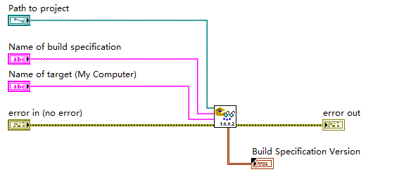

This is the VI.
Here is my specific configuration.

I don't think that VI is supported in run-time engine!

Do you mean that this VI does not support running as an application?
I didn't find any specific details about VI.
Usually it says in the help dialogue if VI is not supported in runtime, but this one doesn't say anything.

It is specified only for Build.vi but I think none of the VIs from Application Builder palette can be called in run-time engine. It makes sense since build operations are specific to IDE.

The vi uses scripting methods to manipulate project properties.   No, it can't run in the RTE since scripting is not supported.
