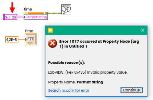

@rolfk wrote:
I very much doubt it. The whole string formatting is programmed in C. The C runtime library only knows ASCII as normal character set. It also mostly supports the locale concept that adds additional characters based on codepages. And theoretically it could be used with UTF-8 as locale...
Well, Unicode support in our dreams (but copypasting thin space into string works), but even If I try to put single ASCII space into format string in attempt to get some empty distance, I have this:
So, the question is — how to insert "normal" space between digits and unit in numeric indicator use case shown above (the difference between thin space and regular space is just one pixel at this font size). And this mission seems to be impossible for me.
You can't! The SI indicator for sub standard quantities such as kilo, milli, nano etc is part of the %p format specifier. There is no way as far as I know of to add an extra qualifier like the #. or similar to that format specifier to indicate that you want a space between the digits and that quantity indicator. Adding it to the string format doesn't help either as you end up with a display like 1.234m A. The format specifier for string formatting is a very powerful feature, but you can't make it do anything you like. The LabVIEW version leans very much on what the Standard C library defines and implements things beyond that but this is an endless resource sink to add more and more of such features and makes the already extremely complicated format string parsing only even more complicated.
In fact the LabVIEW implementation deviates in certain areas from the current Standard C definition mainly because when it was implemented (~1988) they choose to use unused format specifiers for LabVIEW specific things that later got used by the Standard C definition for other things.
