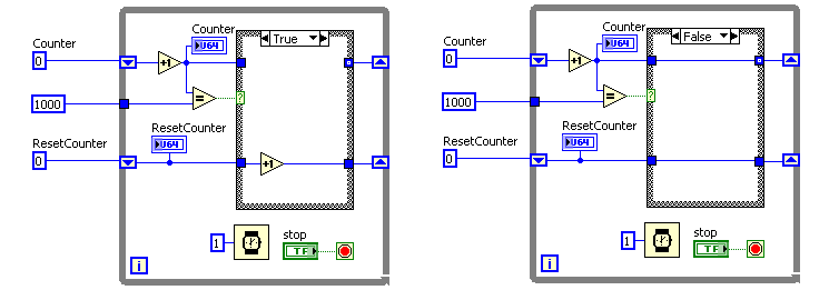

I am just developing a code.
Its purpose is it needs to increment to a set of value(for ex: from 1 to 1000) and then it needs to reset and repeat the same until the stop button is pressed.
Also I need to find out how many times it has repeated that.
Please help me how to reset the while loop and start counting again.I have attached my code.

I've done a simple example with what you want.

i recommend you two things:
1.) Clean up your sourcecode. It is on the edge of getting unreadable. Get accustomed to document your code.
2.) Use the quotient&remainder function out of the numeric palette. It does exacly what you are looking for

This would only work if your loop was running pretty quickly, but I only have 8.2 so I can't tell whether it is or not.  If it's running fast enough, this is your best bet.

Thanks Jorge
Really thats the one i was looking for.
Good answer
