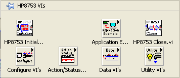

I don't know why you think you 'have' to use the plug&play driver instead of the project style but there is no subVI called HP8753 Collect Data and none of the VIs in the driver call a function called HP8753 Collect Data. There is a subVI called HP8753 Collect and Display Data. What exactly are you doing that you cannot find a subVI? Do you have the driver functions on your palette? Where exactly did you place the unzipped folder. If you have done the installation correctly, you will have a palette just like the one below and there is no need to search for anything. They will just be there.
