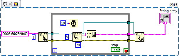

Hi, pardon me for my noob skills but I am not sure how to build an array properly. I took a one time screen shot but I think it isn't quite what you are looking for =/ care to tell me what I should add to receive the necessary data?

Can you make a snippet of the block diagram? I'm posting from my phone and can't view the VI. A snippet is a special type of image and is explained in the help. Your array makes little sense.

Just in case the Original Poster doesn't know about Snippets, this is what he posted ...
Your VI is completely pointless. Why would we need an array containing the last received value N times?
Buidling an array is a core LabVIEW skill, and if this is giving you problems, you should probably start with a simpler problem and continue with the tutorials.
Instead run the attached VI and follow the instructions on the front panel.
(And please, change the VI name when attaching a modified version. It is difficult to keep track of things if different versions of a VI all have the same name).
From the picture, we obviously get at least two lines of numbers, but it is not not clear at all what you are receiving because we cannot see the nonprintable characters.
