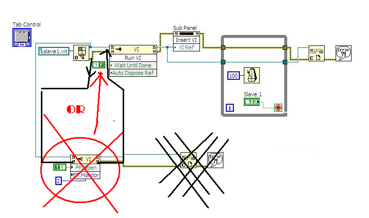

Hello..
I'm doing this, but an error is poping up it says "cant open vi in subpanel because VI is all ready open".
Any idea?

That's because you have two nodes running in parallel.  An Invoke node to run the VI, which also opens it.  So you do not need the code at the bottom.  You could configure the VI to show Front Panel when called.
If you DID want to force the opening of the Front Panel before running the VI, then you would place the property node (FP Open) in front of the Invoke Node (Run VI). But that is not necessary in this case.  So delete the stuff at the bottom.
Also do not close the reference that you are still using later.  You need to understand the dataflow of your VI
