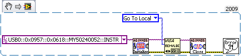

DMM Agilent 34405A
Go To Local is working. I am lucky bastard.
20977iA61436465E394055
Message 8 of 8
