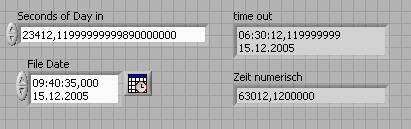

VI "Date Time to seconds" manipulates fractional seconds
Entering a fractional second e.g. 15.001 or 59.999 results in a manipulated fracional part if the value
is above ----,008. See attached Example.
(2,812 Views)
This is just a normal limitation of the precision of floating point numbers in general. Watch what happens if you increase the number of visible digits in your vi:
Please refer to this link for further explanations.
