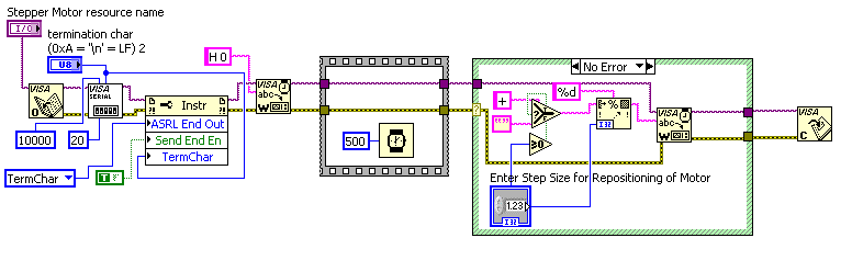

Sure thing.  Fairly new to this.  The VI references SR400*.*, which are subVIs that control a photon counter.  No problem with that.  The problem is with the stepper motor, which I select from the VISA Resource I/O menu on the Front Panel.  On the block diagram you see a Case Structure labeled "Repositioning of the Stepper Motor Without Running Loop"; it's controlled by the box with the green border on the Front Panel.  It writes just a couple of simple commands to the motor.  If I can get that section to work, I'll be in good shape.

The first thing I see is that you dont have the baud rate, data bits or parity wired up, they are just set to default.  Make sure that these settings are correct for communicating to your motor controller.  I would suggest using the shipping example "Basic Serial Write and Read.vi (Under Help>>Find Examples..., and search for this VI title).  Use this VI to establish communication with you motor.  Let me know if you have success.

The default settings for Configure Serial Port seem to be the right settings.  I went ahead and typed them in and still get no movement of the motor.  Although, of course, it does move when Highlight Execution is "on", which is odd.

Try putting a wait in between your first VISA write and the case structure (the one that is controlled by the error wire).  It may be the case that the first write is sent, and before the motor can respond the second write that is within the case structure is sent.  Just use a flat sequence with the Wait(ms) function to force the VI to pause.  It is the only reason I can think of that the motor would turn in debug mode but not in real time.
