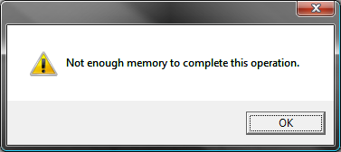

Ugh.  It turns out that I didn't solve the issue after all.  Over the weekend my executable popped up a bunch more of the ambiguous "not enough memory..." dialogs.  I tried something else, however and made an important observation:
Considering that the issue hadn't shown up before I added the "web viewer" subVI and turned on the NI web server in my build, I strongly suspected that it had something to do with those components.  When building my executable this time, I put a disable structure over everything in the web viewer VI to rule it out.  I still left the NI web server turned on, however.  My HTML file displays an automatically refreshing screenshot of the web viewer VI, so I turned down the timer interval so that it refreshes every half a second or so.  (To reproduce the error as quickly as possible.)
I then observed the memory usage in Sysinternals' Process Explorer (like Task Manger except better and more detailed).  When I navigate to the web page, thereby connecting to the NI webserver, the executable's memory usage immediately starts increasing by leaps and bounds.  Something like a MB or two every five seconds!  If I navigate away from the web page, the memory growth stops.  (And never decreases!  It's as if memory is never being deallocated)

Ah, here we go.  Here's the offending dialog:
I hate it when that happens!
