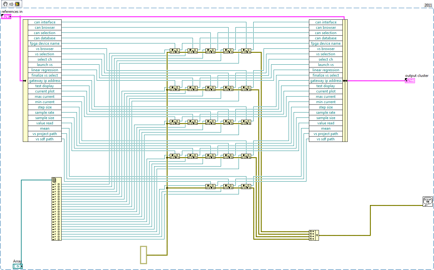

What I initially tried to do was make a cluster type def. with all the reference types that I plan to put on my front panel so far - then I referenced my Main.vi without opening the front panel and grabbed all the control references, but there are generic and I tried to typecast them to the strict classes that I want to use.  The snippet below shows what I tried.  I also included what my type def. is as well in case that might help. Some of them work and some of them don't.  Why will it not work? And what solutions are there available to do what I want?  Or something even better?

Please be more specific than "Some of them work and some of them don't." What do you mean by "work"? Which ones? What types of controls? In what way do they not work? What error or behavior occurs?

What I mean by "some work and some don't" is that when I use highlight execution some say "OK" and others give me error code 1057 - which is saying it cannot be cast to that type.  Why wouldn't it be able to cast to a more specific type regardless of what it is?

I guess some of my questions have less to do with my specific problem and more to do with how this "to more specific class" VI works and what it's proper use and limitations are.
